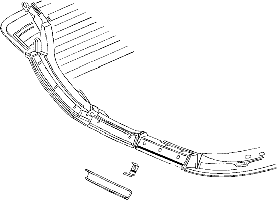

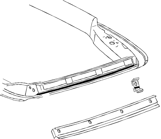

- APPLY A SMALL BEAD OF BEDDING AND GLAZING COMPOUND TO THE SIDE RAIL OR COUPE (SEE FIGURE 1 (COUPE) OR FIGURE 2 (CONVERTIBLE); THEN REINSTALL THE BLOW-OUT CLIP.
- SET BLOW-OUT CLIP IN PLACE AND APPLY A SMALL BEAD OF BEDDING AND GLAZING COMPOUND OVER THE TOP OF THE BLOW-OUT CLIP (SEE FIGURE 1 (COUPE) OR FIGURE 2 (CONVERTIBLE).

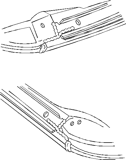

- RESEAL THE FRONT AND REAR CORNERS ON THE COUPE AND THE FRONT CORNER OF THE CONVERTIBLE WITH WEATHERSTRIP ADHESIVE; 3M(R) P/N 08011, OR EQUIVALENT (SEE FIGURE 3).
