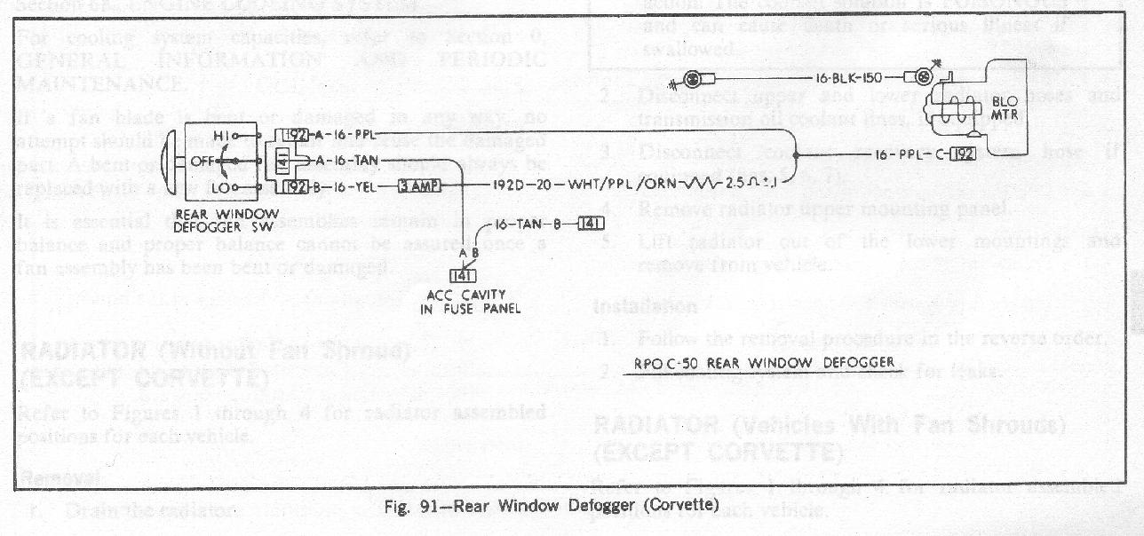

1973 Corvette: Electrical Schematic: Rear Window Defogger
Estimated Reading Time: < 1 Minute
Attached below is the electrical schematic for the rear window defogger system on the 1973 Corvette.
