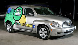

One of GM's several flexfuel vehicles is this HHR Panel truck. No, all FF GM products do not come with this ugly-assed paint job. It was a one-off HHR show truck for the 09 Chicago Autoshow. Image: GM Communications

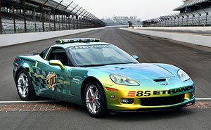

GM's slightly modified, E85-buring Z06 which paced the 2008 Indianapolis 500 and the Woodward Dream Cruise. Image: GM Communications

Last year, GM built a near-production Z06 concept powered by an E85-fueled (but not flex-fuel) LS7 as the pace car for the 2008 Indianapolis 500, Detroit Sports Car Challenge and Woodward Avenue Dream Cruise. While the E85 used in that Z06 concept, also, bared little resemblance to the E85 regular folks pump into their flex-fuel Tahoes, clearly, there has been some thought about a flex-fuel Corvette. Since it would produce less performance and less gas mileage, won't help the environment nor contribute to energy "independence," all we can ask is: "Why?".
