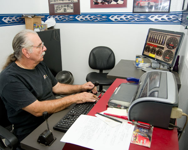

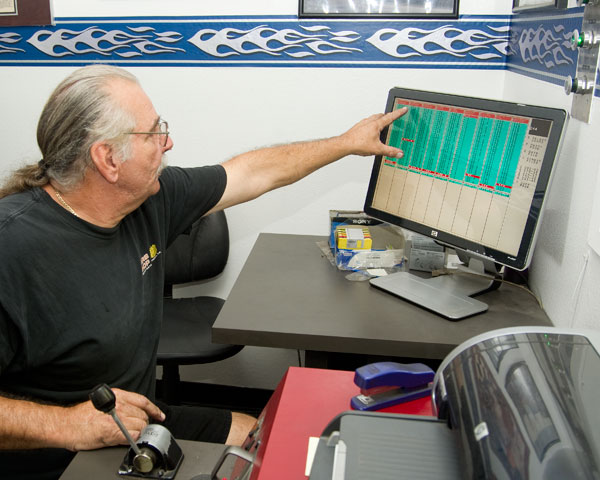

Once I was through changing things, to validate my work, I took our 850 to the Carb Shop and had owner Bob Verbancic run it on his 540-cuin. Big-Block Chevy carburetor "test engine". After making a couple of pulls with my 850 on his test engine, Verbancic commented, "Not bad." then added, "For an 850 without a lot of the mods a high-end carb would have have, your fuel curve at wide open throttle is pretty good. On our carb test engine (540ci.), part throttle was a little lean, but I'd expect that. Also on a 540, at WOT your carb was generating 2-in. of vacuum which means it's a little small for a 540, but...it's probably ok for a 460 with your camshaft and the rpm you run. If you were to install modern aluminum heads and a bit more camshaft and extend the rpm range to 6,800, you'd be better with a 950."

Bob Verbancic at the controls of the Carb Shop's 540 Big-Block which is used to develop and validate all the modified carbs the shop produces.

After running some tests, Verbancic paid our "semi-DIY" tuning work a compliment.

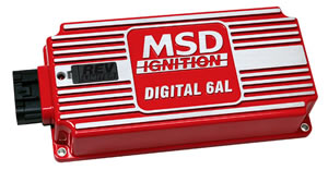

Robust ignition goes hand-in-hand with properly calibrated, high-performance carburetion. Firing lean AFRs at part-throttle with minimal misfire as well as being able to perform at 6500-rpm can be a tough test of an ignition system.
Before taking on the Double-Pumper tuning challenge, make sure your ignition is up to snuff.
