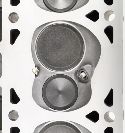

CAC: The injector is in the head and injects gasoline directly into the chamber, kind of like a diesel...
SW: Yes.
click for larger view
Click image for larger view
Through the miracle of Adobe Photoshop, we can show you what the combustion chamber might look like in an Gen 4 V8 DI head.
Image:  Author
CAC...and it's very high pressure compared to....
SW: It's very high, compared to port fuel injection, but low compared where diesels operate.

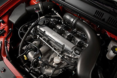

SW: I go home smiling most nights. When you look at this job, globally, I smile even bigger. The four-cylinder team in Europe--almost as big as the Small-Block in terms of volume--do just as well as the Small-Block guys. Look at that LNF turbo, the L850 guys (Ecotec engine team) did? That little monster is a four-cylinder, turbo, direct injected (used in Chevy Cobalt SS and HHR SS along with the Saturn Sky Redline and the Pontiac Solstice GXP) and makes 130 horse per liter. Look at the direct injection on the high-feature V6...won Wards 10 Best Engines this year.

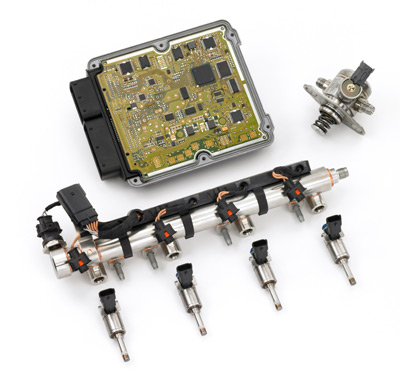

This is the direct injection hardware for the LNF. V8 hardware would look similar but with a fuel rail typical of V8s rather than an I-4.

The twin-cam, 2.0-liter Ecotec, LNF, used in the Cobalt SS and the HHR SS. At 260-hp, this engine makes an astonishing 130-horsepower-per-liter. Part of that comes from direct injection. Will the 2013 Corvette have a 4.8-liter, 500-hp supercharged DI "LS10" base engine? Wadaya think?
