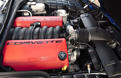

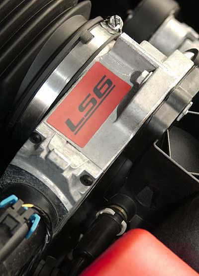

In so many cars, today, engine compartments look so neat and understated. Other than red coil covers and an "LS6" plate on the throttle body, the engine looks like that in any other C5. It puts out 405 SAE het hp. Rated with the old gross power system of the bygone Muscle Car era, it would make about 450hp. Understated, indeed. No wonder the car runs mid-12s.

The LS6 was introduced in 2001 with 385hp. The following year, it got bumped 20hp with a more aggresive camshaft, stiffer valve springs and lighter valves. It's remained at 405hp ever since. Some Corvetters compare LS6 to the LT5, a 405hp DOHC 350 in '93-'95 ZR-1s. The comparison proves the march of technology is always beneficial. The '02-'04 LS6 produces the same horsepower as the LT5 but does so with a wider torque band, two-valve heads, pushrod valve gear, slightly less displacement, less weight, better fuel economy and lower cost.
LS6's image was tarnished a bit by an oil consumption scandal in its first year. GM addressed the problem with a technical service bulletin fix in late '01 for all LS1s and LS6es consisting of second compression rings having a redesigned scraper face and a higher tension, oil ring expander. A new, LS6 valley cover with revised sealing was released early in '02. Both these fixes were put in production, the rings at the start of '02 and the valley cover during that model year.
One neat thing about driving an LS6 is its fat torque curve and that it likes to rpm. Whereas the LT5 before it, fell-off past 6000 rpm, the LS6 peaks at 6000 but stays fairly flat to its 6600 rpm rev limit. Another endearment is its exhaust sound, especially with the throttle wide open and the engine pulling to peak power. More sporting and a little louder than that of the base model, it's the first Corvette exhaust I can honestly admit that I could leave stock. The Z06 system is also unique in that its back half is made of titanium which makes it 18 lbs lighter than the standard part.
The LS6 has remained unchanged since '02 and the big story we wanted to focus on with the '04 was handling. Those interested in more, detailed information on LS6 can go to http://www.idavette.net/writers.htm and find a series of articles on the LS1 and LS6 engines.

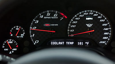

The C5 cluster and IP are the bomb. The instruments are placed and accented visually to create a sort of 3D effect we've always thought was pretty cool-even cooler at night with the cluster's ultraviolet-lighting. Right then, coolant temp was shown, but the IP display can read all kinds of interesting and important stuff, some of which we don't even know.
Image:  Author
The Z06's interior appearance is attractive, efficient and focused on providing information to the driver. Standouts are an easy-to-read instrument cluster and an IP display capable of reading the condition of engine parameters along with tire pressures. It even can display engine controls diagnostic information though we were unable to sample that ability because our test car had no Owner's Manual for us to find the instructions on how to use it and other features such as programmable exterior lighting, security system and keyless entry.
