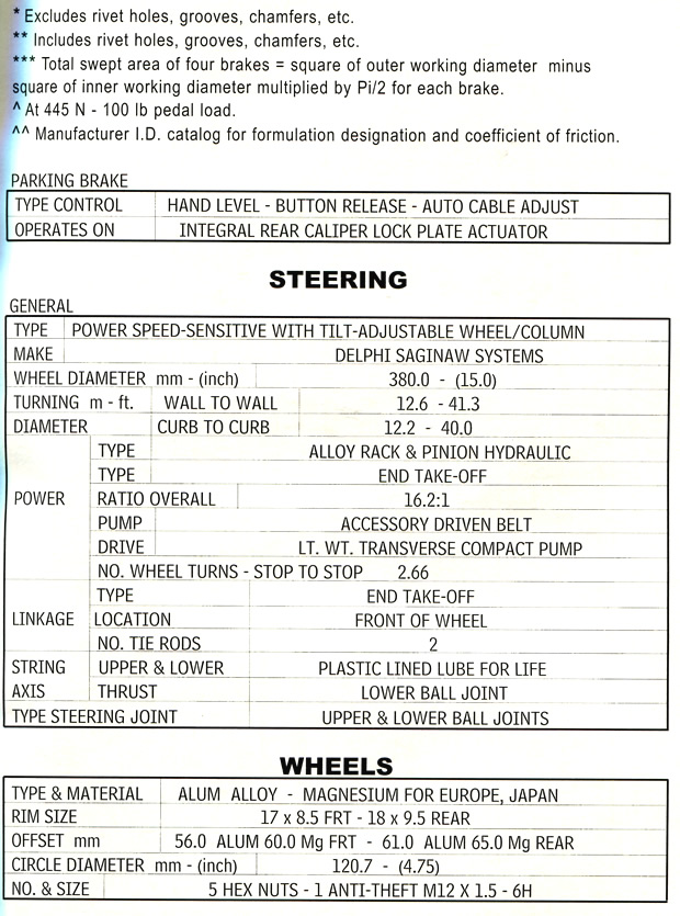

| Steering | ||||
| Power-assisted, speed-sensitive, magnetic variable-effort power rack and steering | ||||
| 16.1:1 | ||||
| 2.32 | ||||
| 40.0/12.2 | ||||
| 41.3/12.6 | ||||

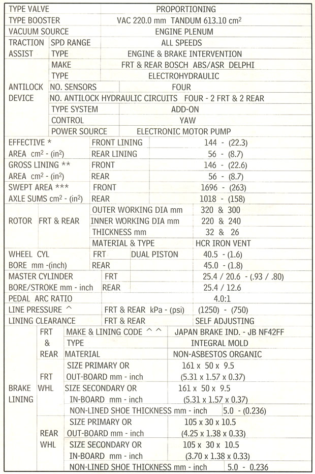

| Brakes | |||
| Power-assisted, four-wheel vented disc with 4-wheel ABS | |||
| U. S. STANDARD | METRIC | ||
| 22.6/8.7 sq. in. | 145.8/56.1 sq. cm. | ||
| 22.3/8.7 sq. in. | 144/56 sq. cm. | ||
| 12.6 x 1.26 in. | 302.3 x 1981.2mm | ||
| 11.8 x 1.0 in. | 302.3 x 1981.2mm | ||
| 263/158 sq. in. | 1696/1018.0 sq. cm. | ||

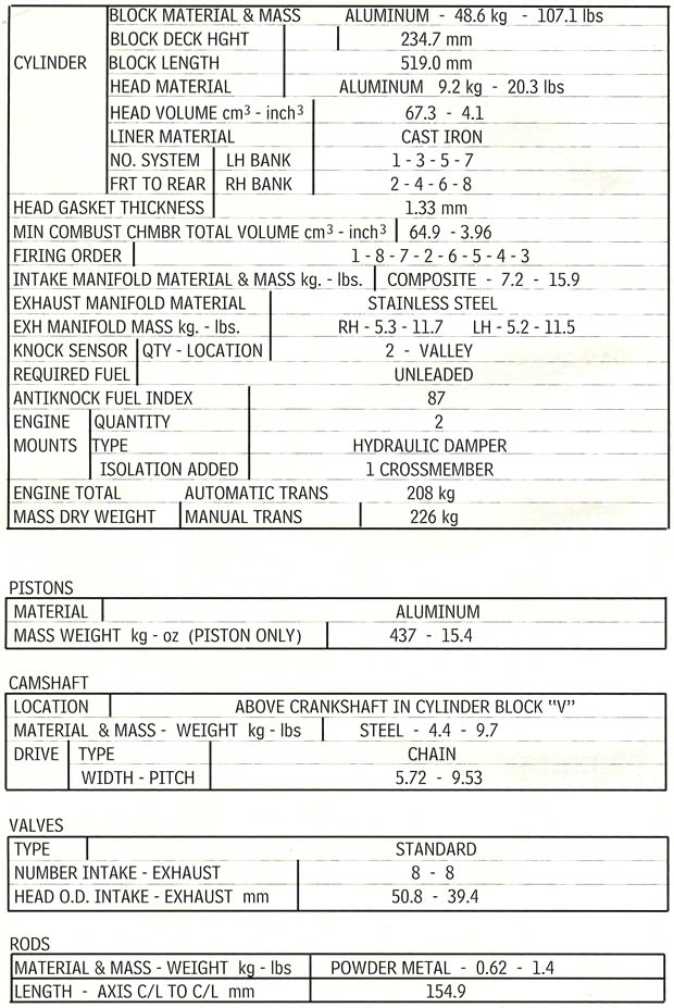

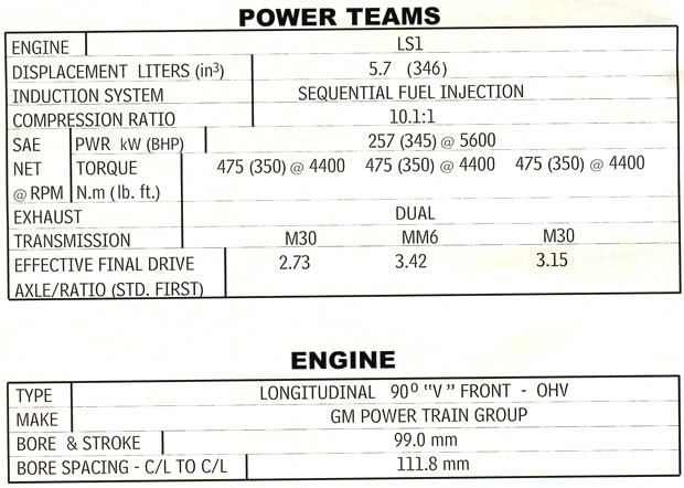

| Engines | |||
| 5.7 Liter (LS1) V8 SFI | |||
| Cast aluminum | |||
| Cast aluminum | |||
| Overhead (OHV) intake manifold | |||
| Yes/Roller | |||
| 3.90 x 3.62 | |||
| 99.0 x 92.0 | |||
| Chain | |||
| 6000 | |||
| 5.67/346 | |||
| 10.1:1 | |||
| Sequential Fuel Injection (SFI) | |||
| 345 @ 5600/257 kW @ 5600 | |||
| 350 @ 4400/475 N-m @ 4400 | |||
| Aluminized stainless steel | |||
| 4, rear center exit | |||
| Coil near plug | |||
| 50 at idle; 120 maximum | |||
| 600 | |||
| Premium unleaded | |||

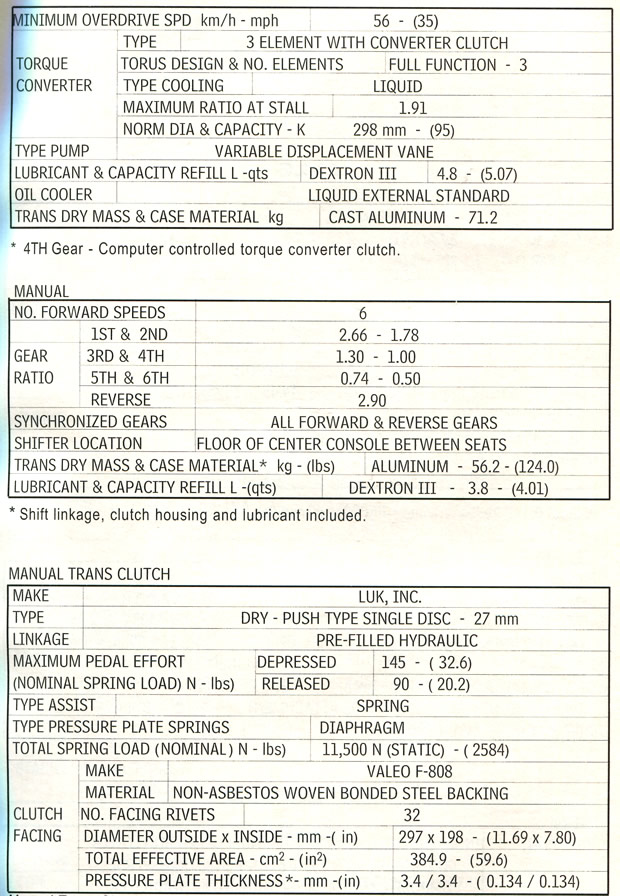

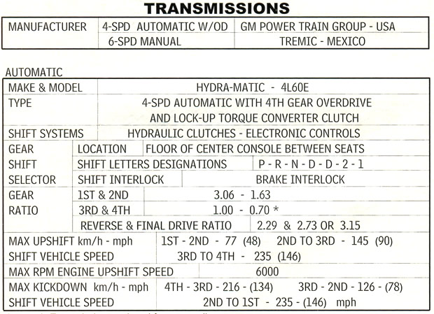

| Transmissions | |||
| Model | Corvette hardtop | Corvette coupe/ Corvette convertible |
| 6-speed manual (std.) | 4-speed elec. automatic with overdrive (std.) |
6-Speed Manual (opt.) | |
| RWD, mounted ahead of rear axle |

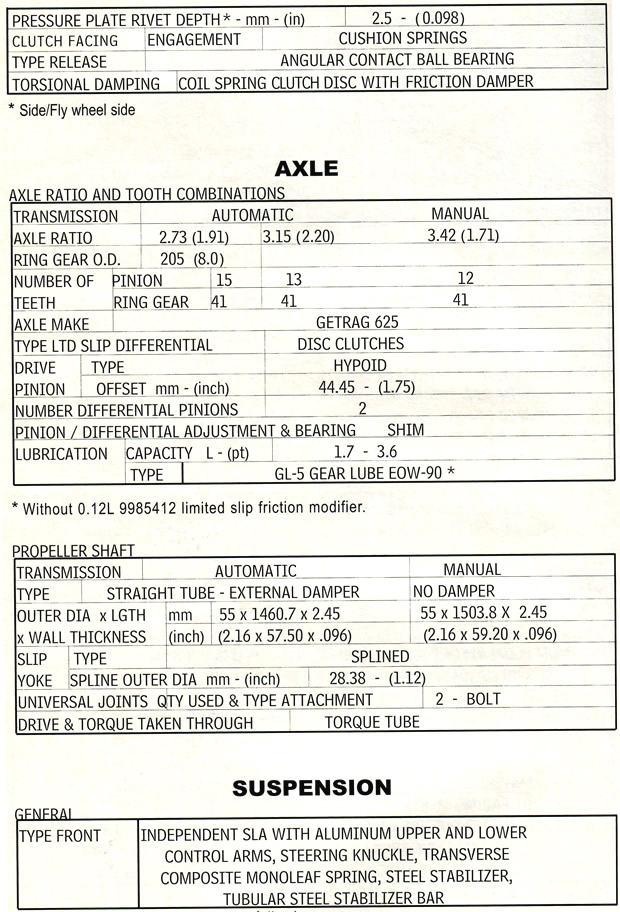

| Gear ratios: | |||
| 2.66 | 3.06 | 2.66 | |
| 1.78 | 1.63 | 1.78 | |
| 1.30 | 1.00 | 1.30 | |
| 1.00 | 0.70 | 1.00 | |
| 0.74 | - | 0.74 | |
| 0.50 | - | 0.50 | |
| 2.90 | 1.91 | 1.91 | |
| Final-drive ratio | 3.42 | 2.731 | 3.42 |
| 1 3.15 with optional Performance Ratio. | |||

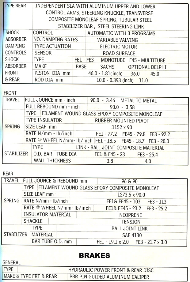

| Chassis | |
| Integral perimeter frame with center backbone/all-welded steel body frame construction | |
| Fiberglass-reinforced plastic | |
| Suspension -- Front | |
| Independent SLA forged aluminum upper and pressure-cast aluminum lower control arms; forged-aluminum steering knuckle, transverse monoleaf spring and steel stabilizer bar, spindle offset | |
| Link/23.0 (25.4 with hardtop and optional Z51 Handling Package) | |
| Suspension -- Rear | |
| Independent 5-link design with toe and camber adjustment, cast aluminum upper and lower control arms and knuckle, transverse monoleaf spring, steel stabilizer bar and tie rods, tubular u-jointed metal matrix composite driveshafts | |
| Ball joint link/19.1 (27.1 with hardtop and optional Z51 Handling Package) | |
