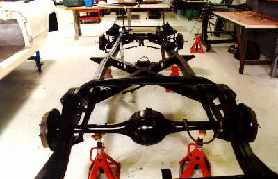

1953 Corvette Number 158 out of 300 BuiltThe frame of No. 158 has been straightened back to perfection, media blasted, hand-sanded and painted perfectly. All other components of the chassis received a similar refurbishing, and the engine and transmission have been reunited with their metal brethren once again. The last months have been spent on one of the most difficult parts of the restoration, restoring the fiberglass body to better than new condition.

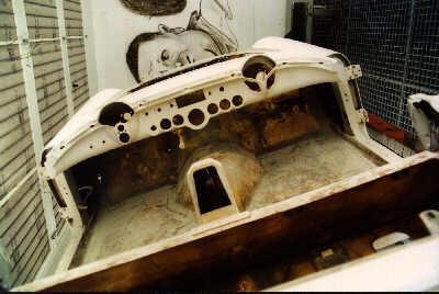

1953 Corvette Number 158 out of 300 BuiltOnce the car was stripped to bare fiberglass, the evaluation process began. All flaws were meticulously noted and a plan of action was developed to remedy them. Using all the knowledge and techniques accumulated over the years, Brand attacked the body and when he was finished, over 50 percent of it had been re-glassed. Hours upon hours were spent performing the tedious task of sanding the top and bottom of the car down to a glass smooth texture.
Even after this step, parts of the original fiberglass not replaced or repaired are still showed its age. You must remember that when this car was assembled, the materials and procedures were very new to the industry, and even though the cars were virtually hand built, the final result was something less than perfect. The original fiberglass that was not subject to repair looked as though the surface had pits in it, not a good base to use for a concourse "over-restoration." The combination of the right skills and the correct materials will overcome even these defects.

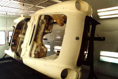

Using a precise mixture of application-specific epoxy primers, four gallons of 'Awlgrip 545' were laid down in the first step of smoothing out the top and bottom of the car. Once the base epoxy primer had dried sufficiently, an additional three gallons of 'Awlquick' were sprayed on both sides of the body. The combination of these products completely fills in all the pitting and cracking in the old fiberglass and is the basis for initial sanding. 100-grit sandpaper is used to perform the rough first level of sanding. Then more Awlgrip 545 and Awlquick are sprayed over the sanded area.

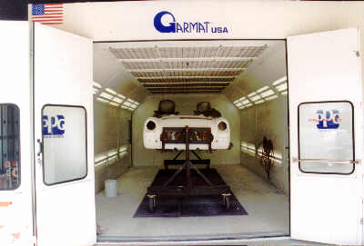

This process continued until the surface was smooth enough for the next level of sanding. Then it was gone over with a finer 400-grit paper to get it ready for the next stage of preparation. Any flaws discovered at this stage are fixed by going back to the primer steps and re-sanding again by hand. Only when the surfaces of both the top and bottom of the car have reached perfection will the body be ready for painting. As of March 2001, the body has progressed to a level where it is ready to be painted. Over 1,100 man-hours have been put into the preparation of the body alone, and the final coats of paint remain to be done.
