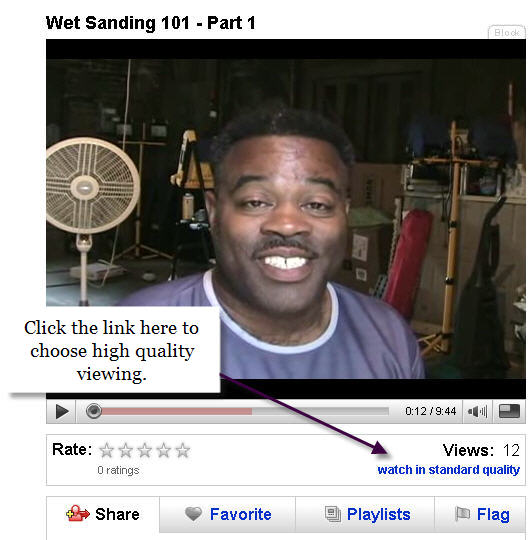

(Be sure and choose the "high quality" link so that you can see the process in very good detail, and my ugly mug in all its glory... ;) )
Video: Part 1: Wet Sanding
Video: Part 2: Final Wet Sanding & Compounding
Video: Part 3: Final Compounding and Conclusion

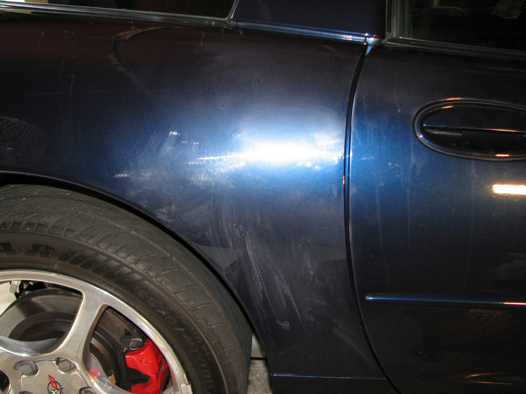

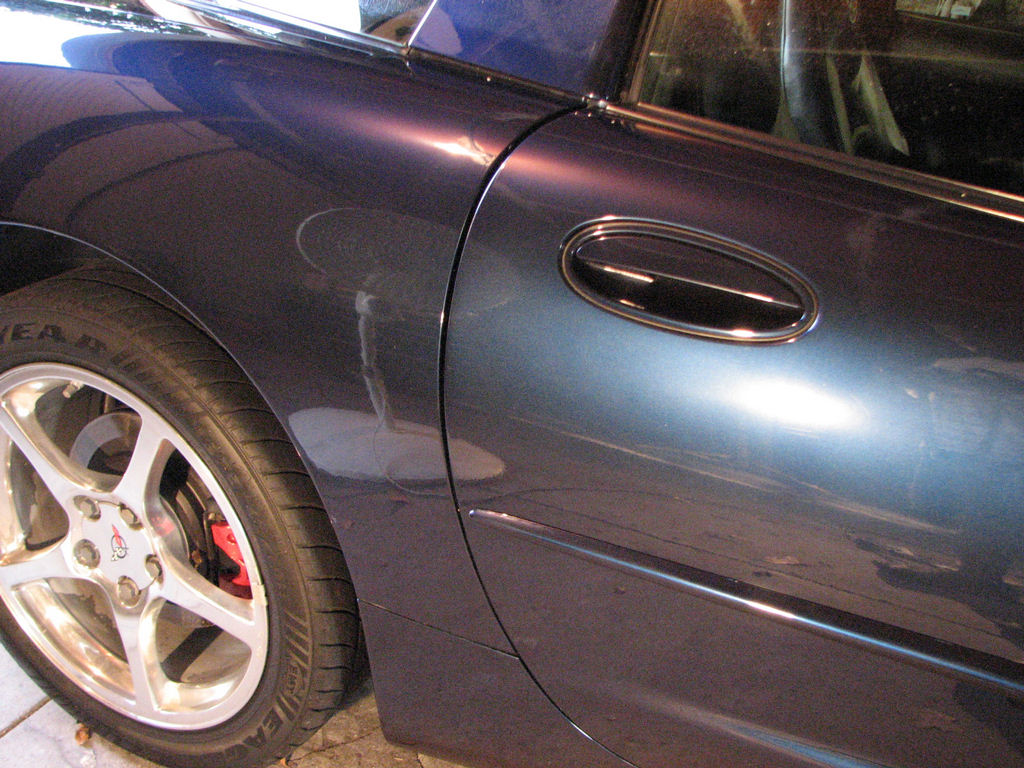

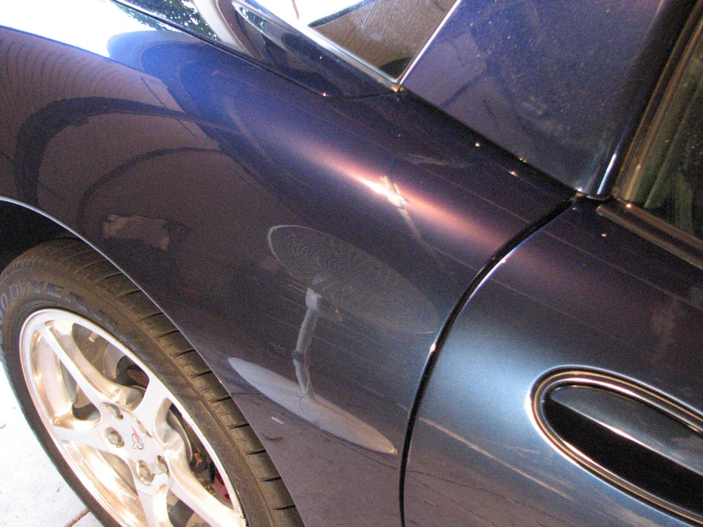

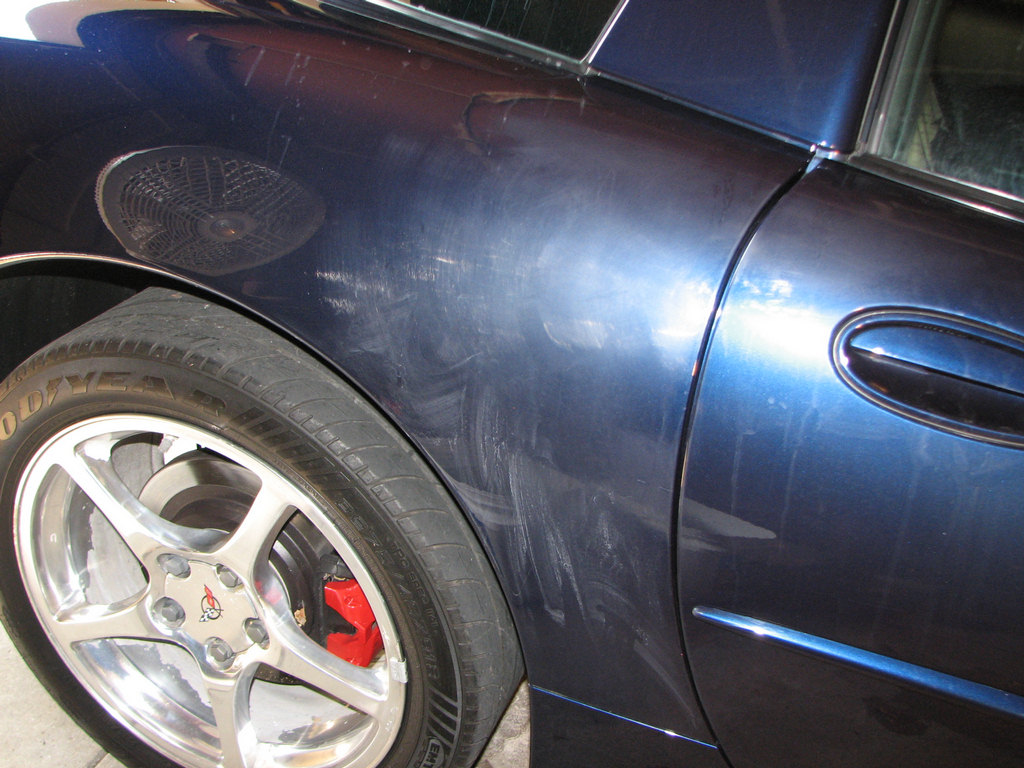

Here’s some before and after pictures of another area that I was working on. The scratches were on the rear quarter and near the top of the door handle. The after pictures are just after I used the fine cut cleaner. There is no polish on the car yet.
Picture 1
Picture 2
Picture 3
Picture 4
