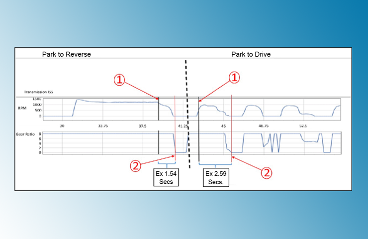

Use GDS2 to monitor engine RPM and the transmission input speed sensor (ISS) prior to starting the engine. Start the engine with the transmission in Park and shift the vehicle from Park to Drive or Park to Reverse with the service brake applied. The ISS should drop to zero within three seconds, which is the clutch engagement time. Recording the GDS session log can be useful in diagnosing the condition.
Delayed engagement of Park to Reverse or Park to Drive is present if the time difference between the gear selected (Pt. 1) and the transmission input shaft speed reaching 0 RPMs (Pt. 2) exceeds three seconds. (Fig 13)
Fig. 13
In most cases, the transmission will engage in three seconds or less, which is considered an acceptable engagement time and no repairs should be attempted.
