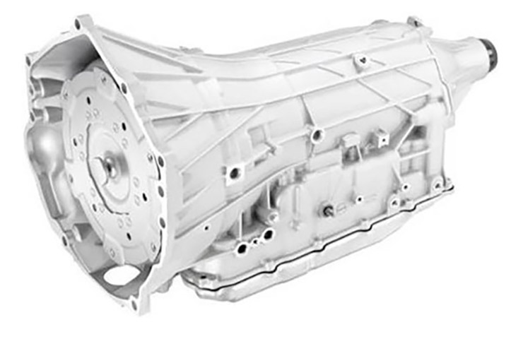

The 8-speed automatic transmissions (RPO M5N, MNU, M5U, M5X, MHA, M5T, MQE, MQD) in some 2015-2018 Corvette; 2015-2020 Escalade, Yukon; 2015-2023 Silverado 1500, Sierra 1500; 2016-2018 CTS; 2016-2019 ATS, CTS; 2016-2023 Camaro; 2017-2023 Colorado, Canyon; 2017-2024 Express, Savana; and 2020-2024 CT4 models (Fig. 5) may exhibit hard or harsh shifts.
Fig. 5
There are several steps that should be taken to improve the shift quality, depending on the mileage on the vehicle.

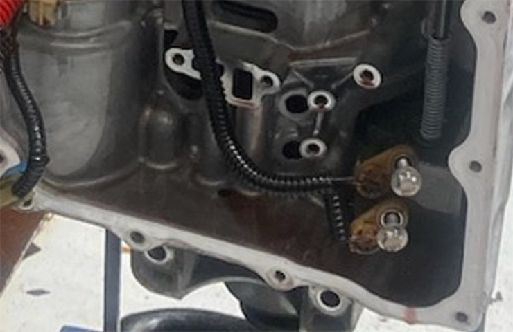

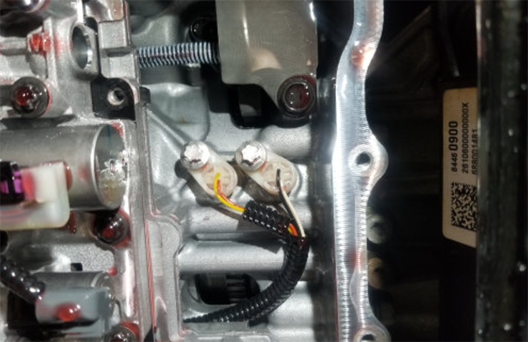

Speed Sensor Installation
In addition, if the speed sensors were recently replaced and the Transmission Service Fast Learn fails for excessive vehicle speed, or if DTCs P0717, P0722, P0746 and/or P0796 also set, inspect the speed sensors for the proper orientation. When correctly installed, the smaller portion of the sensor conduit should be facing the rear of the unit. (Fig. 7, Incorrect; Fig. 8, Correct)
Fig. 7
Fig. 8
