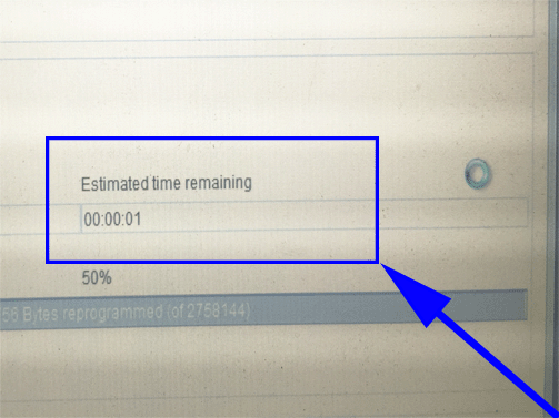

Important: During the SPS procedure, when the estimated time remaining reaches 00:00:01, it may take a few minutes to complete the reprogramming. Be sure to wait until the reprogramming is completed.
