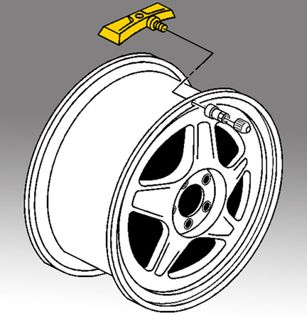

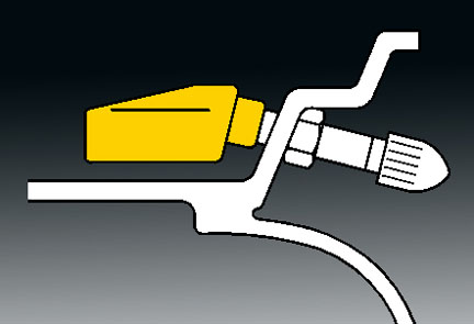

When dismounting and mounting tires, be careful when breaking the bead loose from the wheel rim (fig. 11 and 12 - attached).
If the tire machine’s bead breaking fixture is positioned too close to the TPM sensor, or pressed down directly on top of it, it may contact the sensor as the tire bead breaks away from the wheel rim. This can damage the TPM sensor and require the sensor to be replaced.
Also be careful when transferring the tire bead to the other side of the wheel rim. As the tire machine rotates and the tire bead is stretched around the wheel rim, the bead can come in contact with the sensor. This can also cause sensor damage, requiring replacement. Damage can be avoided by correctly positioning the wheel and tire in relation to the mounting/dismounting head.
