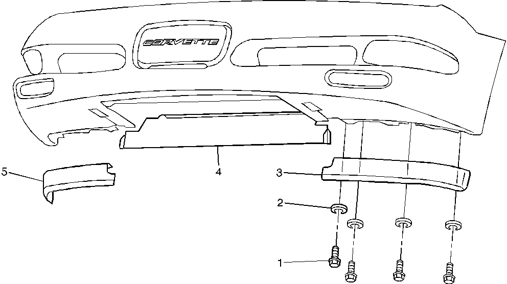

SUBJECT: LOOSE LOWER FRONT FASCIA VALANCE PANELS (INSTALL ADDITIONAL ADDITIONAL WASHERS)
MODELS: 1997-98 CHEVROLET CORVETTE - BUILT PRIOR TO VIN BREAKPOINT W5127967
CONDITION:
SOME OWNERS MAY COMMENT THAT THE LOWER FRONT FASCIA VALANCE PANELS APPEAR LOOSE.
CAUSE:
THE ORIGINAL WASHERS ON THE BOLTS/SCREWS THAT ATTACH THE LOWER VALANCE PANELS TO THE FRONT FASCIA MAY HAVE WORKED THEIR WAY THROUGH THE HOLES IN THE VALANCE PANELS.
CORRECTION:
ADD ONE ADDITIONAL LARGER FLAT WASHER, P/N 11500365, 25 MM O.D. BY 6.3 MM I.D. BY 2.5 MM THICK (1 IN. O.D. BY 1/4 IN. I.D. BY 3/32 IN. THICK) TO EACH OF THE EIGHT BOLTS/SCREWS (FOUR PER VALANCE PANEL) THAT ATTACH BOTH LOWER VALANCE PANELS TO THE FRONT FASCIA (SEE FIGURE 1). TIGHTEN BOLTS TO 7 N.M (62 LB IN).
