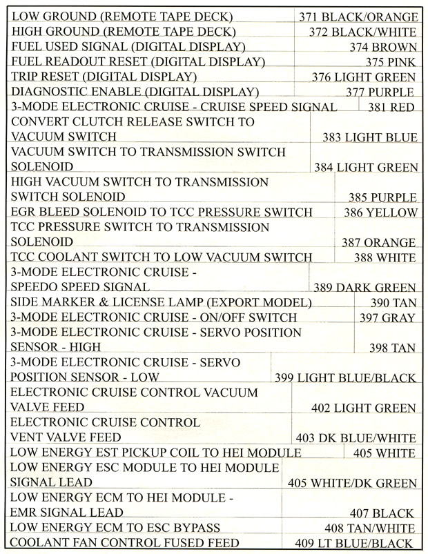

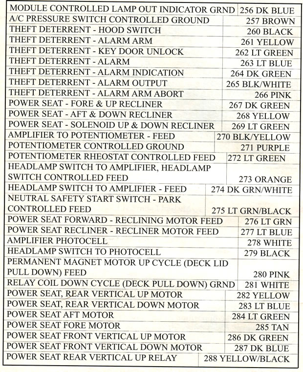

1984 - 1996 Corvette: Wiring and Circuit Identification Estimated Reading Time: < 1 Minute 1163 February 8, 2015 Electrical and Ignition 0 19.40K Below are tables showing the identification of wiring and circuits for 1984 - 1996 Corvettes:
