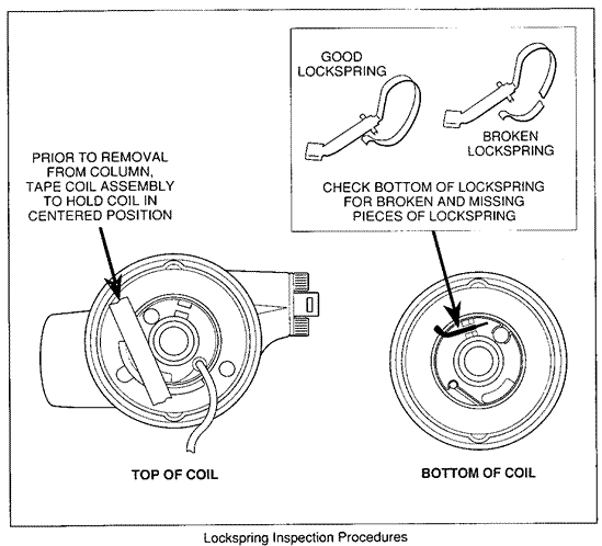

If the "clicking" noise is heard, or if removal of the SIR coil assembly is required during steering column service, check for a broken lockspring as follows:
1 . Disconnect negative battery cable.
2. Disable SIR system following Service Manual instructions.
3. Place wheels in the straight ahead position before removing coil.
4. Refer to 1990 Corvette Service Manual for complete instructions on removing the coil assembly from the steering column. Before removing the coil assembly from the column, tape the coil assembly to hold it in the centered position, as shown in the illustration.
IMPORTANT: If the coil is left free to rotate, follow the centering procedures in Section 3F4A of the 1990 Corvette Service Manual.
5. Remove the coil from the column, turn the coil over, and inspect the lockspring for broken or missing pieces as shown in the illustration.
a. If the lockspring is black, it is not subject to breakage. Leave the lockspring in place.
b. If the spring is brass colored, and is not broken, leave it in place.
c. If the spring is brass colored, and is broken, remove all the pieces of the spring and discard. It is not necessary to replace the lockspring with a new one.
NOTICE: All pieces of the broken lockspring must be removed, or serious damage to the steering column may result.
d. if the spring is missing, it is not necessary to replace it.
6. Replace the coil assembly in the steering column.
