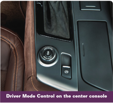

The different driver modes on the 2014 Corvette provide enhanced performance for different driving conditions by changing the throttle progression, shift mode, steering assist, limited slip differential, ride control, traction control, exhaust sound and other calibrations. There are five driver modes that can be selected using the Driver Mode Control located on the center console: Weather, Eco, Tour, Sport, and Track.
If the vehicle was in Weather or Track mode during the previous drive cycle, it will default to the Tour mode the next time the vehicle is turned on. This is design intent. No repairs should be performed.
