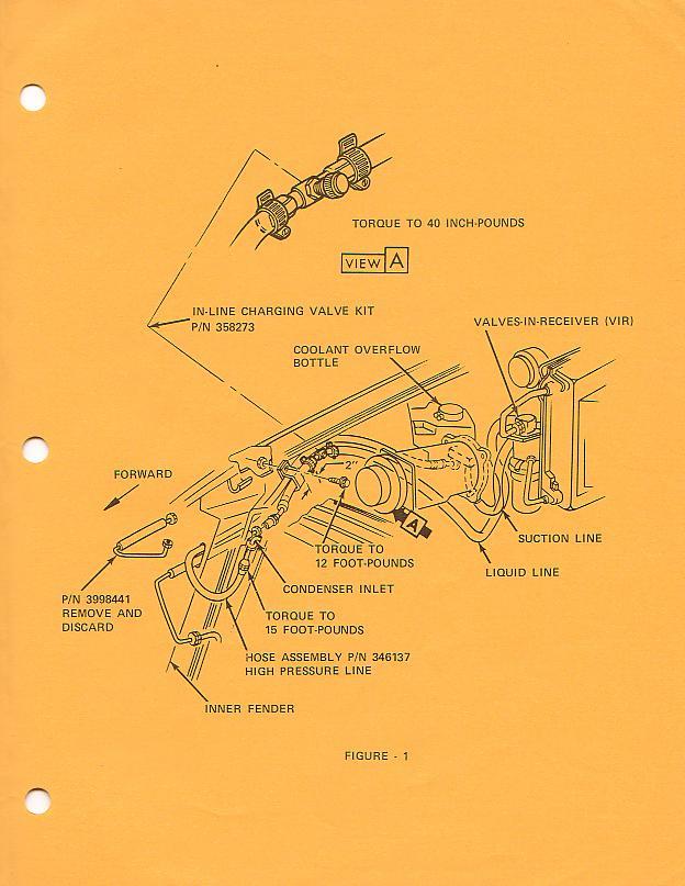

1973 Corvette: Service Bulletin: Exhaust Manifold to Air Conditioning Refrigerant Hose Clearance
