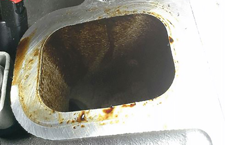

If the head casting line is the issue, the intake port will be wet with a coolant and oil mix. This condition may cause the running rough while warm concern with or without DTCs set. The location where the coolant is running down in the port will look washed down. If this condition is found, the cylinder head will need to be replaced. (Fig. 13)
Fig. 13
