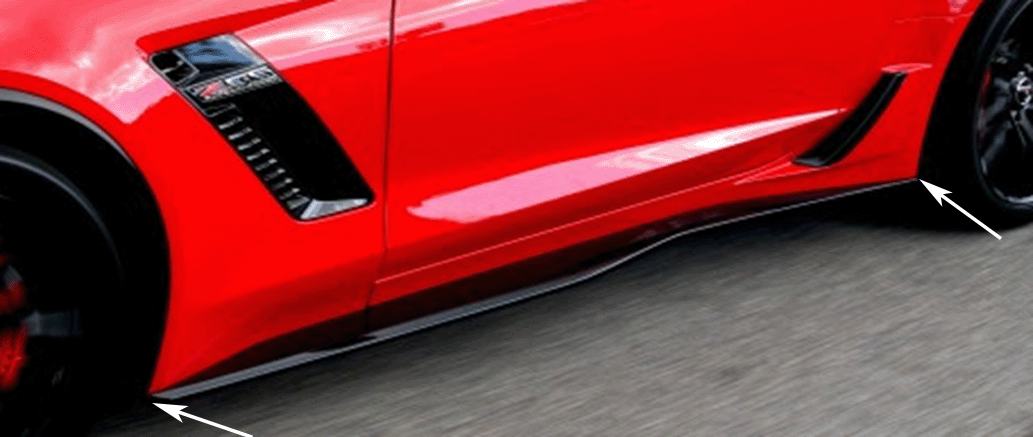

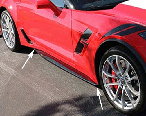

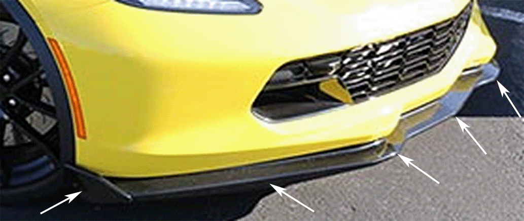

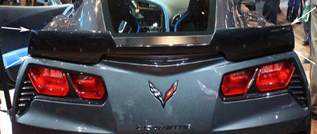

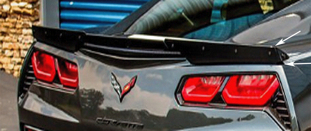

Please confirm the correct aero components are installed during the PDI process. Use the photos and tables below to confirm the correct aero parts were shipped and installed on the vehicle prior to delivery.
Important: The tall end caps and clear bridge are for track use ONLY.DO NOT install during PDI.
SPLITTER
Small
Large
END CAPS
Short
Tall
ROCKERS
Short
Long
WICKERS
Short
Tall
