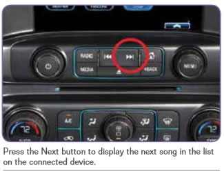

When listening to a connected iPod® in some 2015 LaCrosse, Regal, ATS, CTS, SRX, XTS, Corvette, Impala, Silverado 1500, Sierra 1500; and 2015 1/2 model year Escalade models, Silverado HD, Suburban, Tahoe, Sierra HD, and Yukon Models (only Utilities and HD Pickup Trucks equipped with RPO AVF – Effective Point Control, 2015 1/2 M.Y.), the first song will still display when the next song in the list on the device is playing.
This condition can be remedied by pressing the Next button while the device is playing. This will enable the system to properly display the song information for the rest of the drive cycle. Engineering is currently looking into this condition and more information will be released when available.
