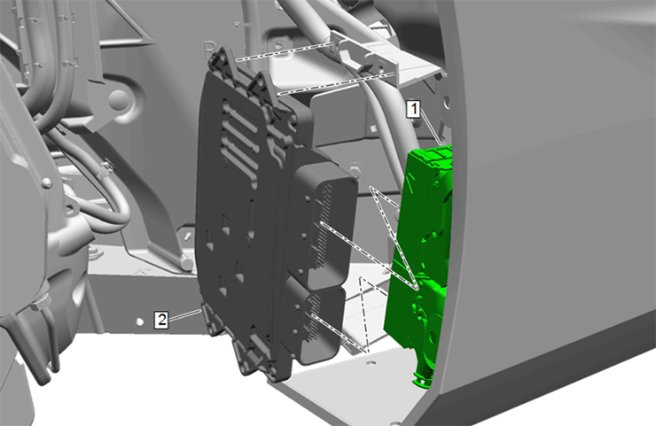

If only DTCs P1967 or P1968 are set, do not request a TCM replacement (Fig. 21) per #PIP5703 (TCM Restriction). Perform the even and odd-related clean procedures in GDS2 and a transmission service fast learn. After completing these procedures, re-evaluate the condition.

2020 Corvette: DTCs Set in the TCM
Fig. 21
For additional information, refer to #PIP5757.
