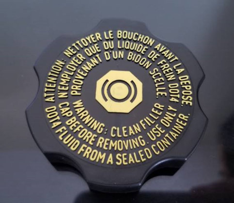

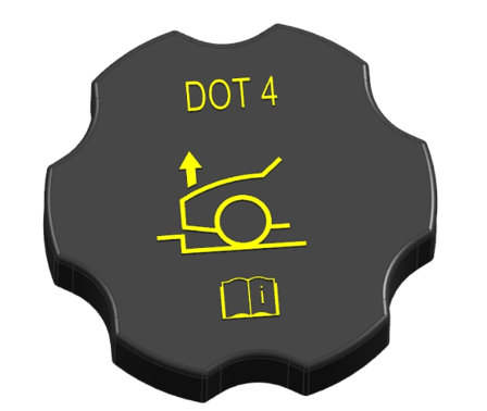

Certain 2020 and 2021 model year Chevrolet Corvette vehicles, may have been built with an incorrect Front Suspension Lift Reservoir cap. |
Correction |
Dealers are to replace the suspension fluid reservoir cap. |

- Remove the front compartment rear access panel. Refer to Front Compartment Rear Access Cover Replacement in SI.
- Locate the hydraulic suspension fluid reservoir mounted on the passenger side of the compartment.
Note: Note: Clean the filler cap and surrounding area before removing the cap.
- Remove the incorrect reservoir cap. Discard the cap.
- Install the new service reservoir cap.
- Reinstall the front compartment rear access panel. Refer to Front Compartment Rear Access Cover Replacement in SI.
