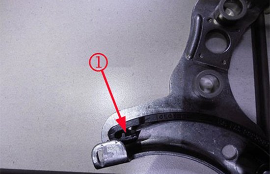

If these conditions are found, the tensioner spring in the timing chain guide may be “short” and not fully seated into the guide pivot end. (Fig. 19) Cycling the oil pump control valve will not cause any changes in the oil pump response. Replace the timing chain tensioner guide.
Fig. 19

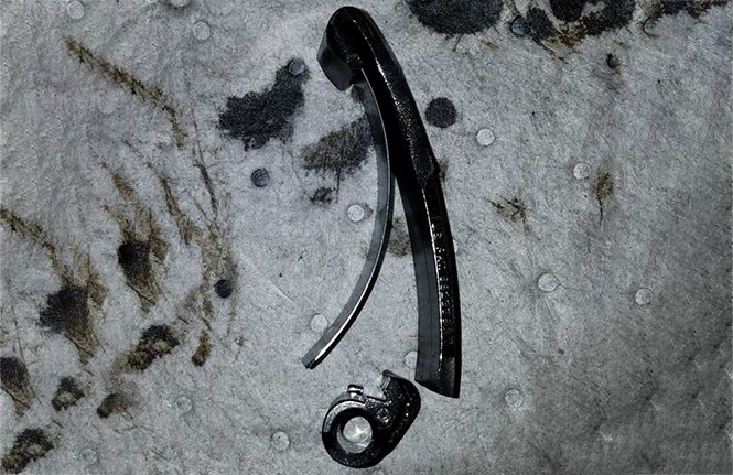

In addition, a broken tensioner shoe (Fig. 20) may allow the spring to rub a hole in the oil pump.
Fig. 20

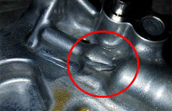

If the oil pump face is damaged or worn, replace the oil pump. (Fig. 21) Also inspect the bearings for damage due to debris from the oil pump.
Fig. 21
