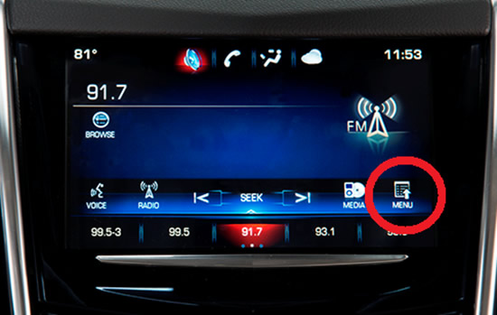

ATS, Corvette, CTS Sedan, Impala, Sierra, Silverado, SRX, Suburban, Tahoe, Yukon models and XTS:
From the home screen on the radio touch screen, select the Audio > Menu > HD Switching Off.
On the CUE system, for example, the Menu option to access the radio settings is on the right side of the Audio page. (Fig. 9)
Fig. 9
If the vehicle has a preset saved as an HD station, the HD will automatically turn on when that preset is pressed. It’s recommended to resave the presets as non-HD stations. Once the presets have been saved, the vehicle will need to power down for five minutes to correctly store the new presets.
