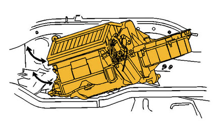

Use special care when removing or installing the HVAC module for service. The HVAC module is seated between a non-removable upper and lower tie bar

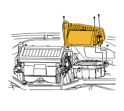

(fig. 11 - attached). The HVAC module must be partially disassembled before removal and installation (fig. 12 - attached).
Refer to SI 2000 to obtain the service procedure for correctly removing and installing the HVAC module. Failure to do could result in damage to the HVAC module.
