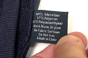

Microfiber towels from reputable sources will have a tag attached listing the specs of the material. This is one of Cal Car Duster's Plush Towels which is a 67/33 mix of polyester and nylon.  Image:  Author

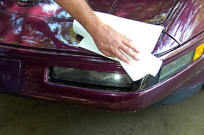

Manufacturing of microfiber towels seems to leave the corners of some of them with hard "nubs"--sort of like the ends of nylon rope which are melted to prevent fraying. These nubs will scratch your clear coat or paint. When we buy a new bunch of towels, regardless of source, we slide our finger tips over the corners of each one, feeling for nubs. If we find them, we use a small, sharp knife or small, sharp scissors or even fingernail clippers to cut the nubs away.

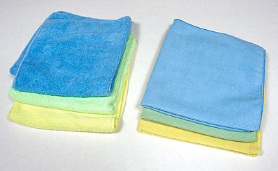

We evaluated microfiber towels from several vendors. The best standard-sized (16x16-in) general-purpose microfiber towels we tried came from C-Magic (3-pack, PN DA404). California Car Duster Company also has 16x16 microfibers (3-pack, PN 22104). They're not quite as heavy, so their ability to hold moisture might not be quite the same, but they are still a good choice and carry a lower price. California Car Duster, also, has a "Clean and Polish Plush Towel" (PN 22200), high-end item designed specifically for finish polishing. It's heavy-weight material, larger (16x24-in.) and has two separate textures, a woven side, for waxing and cleaning, and a sheared side, for finish polishing. The Plush Towel is a bit more expensive, but provides outstanding results and was the best product we tested in the final polish role. We tried 16x16 G.P. microfiber towels from the Eastwood Company, (3-pack, PN 52210) which performed well. Lastly, Grit Guard has a general-purpose microfiber (PN 461-P) which we found does a good job, too.
"General purpose" microfiber towels are just that. They can be used for drying or polishing along with other automotive cleaning duties. They often come bundled in threes. If you want good value, here are two choices: three packs of towels from California Car Duster Company (left) and Eastwood Company.  Image:  Author
Click image for larger view
A little more costly but somewhat better performing are C-Magic's microfiber towels, which are packed in its detailing kits or are available individually and a Grit Guard "Waffle Weave Drying Towel," which is ideal for drying after washing.  Image:  Author
